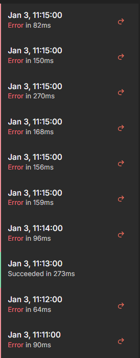

The errors shown in the execution list are intentional.
I added a manual “lock” inside the workflow to prevent multiple concurrent executions.
When multiple executions start at the same time, the workflow intentionally throws an error to block duplicate runs.
So the errors are a symptom, not the root cause.

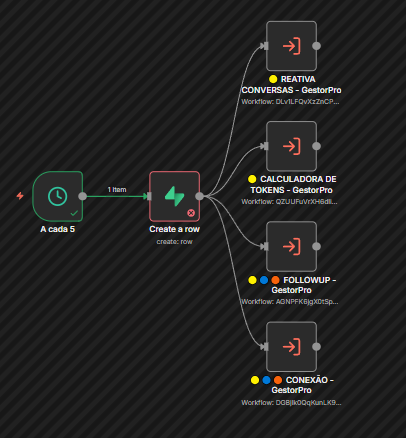

  • The workflow has only one trigger, a single Cron node.
  • Initially, the Cron is configured to run, for example, every 5 minutes.
  • After some time — usually after an update or redeploy — the workflow starts executing multiple times at the exact same second.
  • The number of executions is exactly the same as the number of workers.
