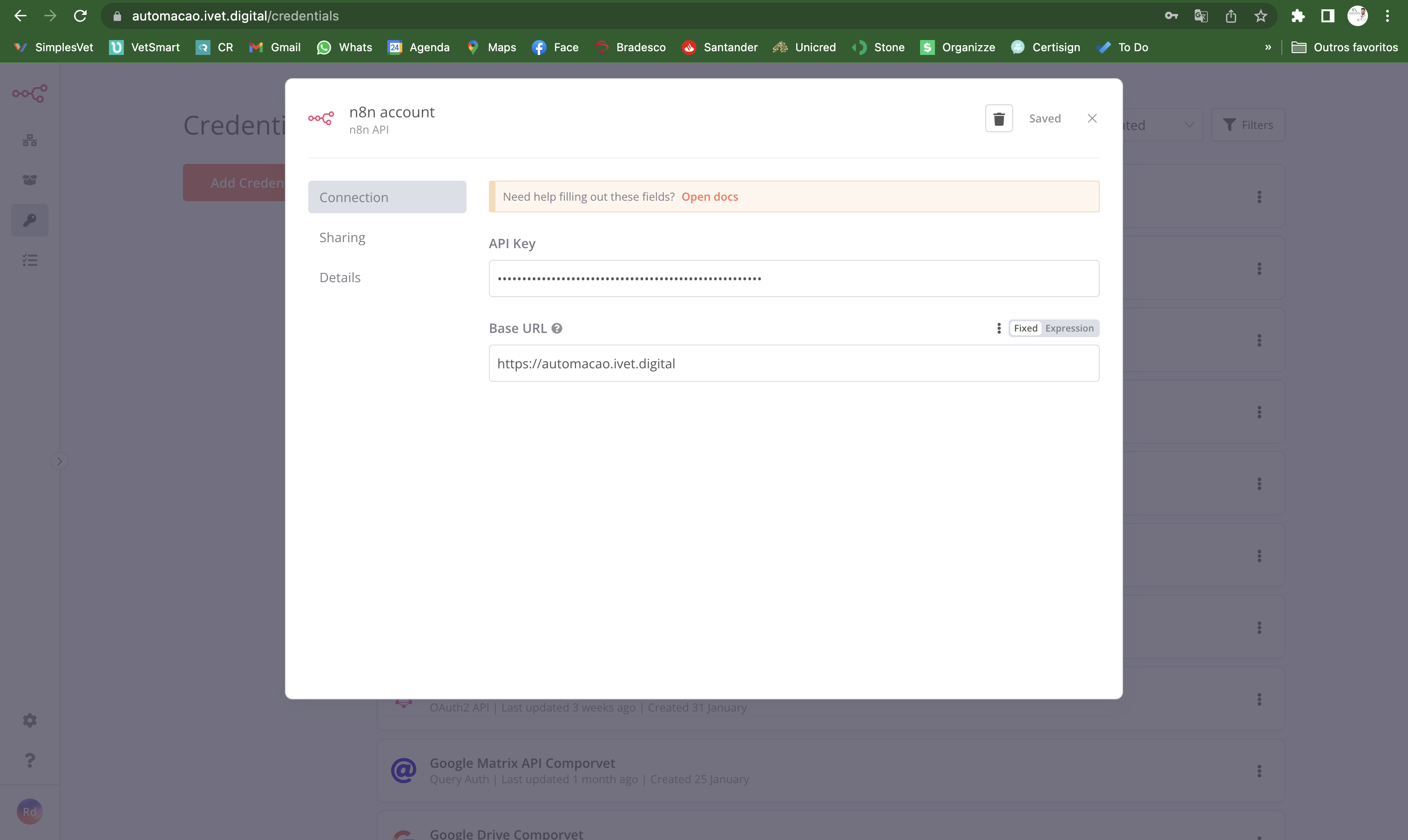

Didn’t know the n8n node. I tried here and I couldn’t run the node. I believe it is because of the n8n credential.
Is the Base URL correct?
Hi @rfdepauli,
usually, a URL like http://localhost:5678/api/v1 should work.
If you are using basic auth, maybe this threat helps: N8n api node cannot connect
Thanks so much for your support once again, @Jon and @FelixL
With these tips it worked perfectly here!
