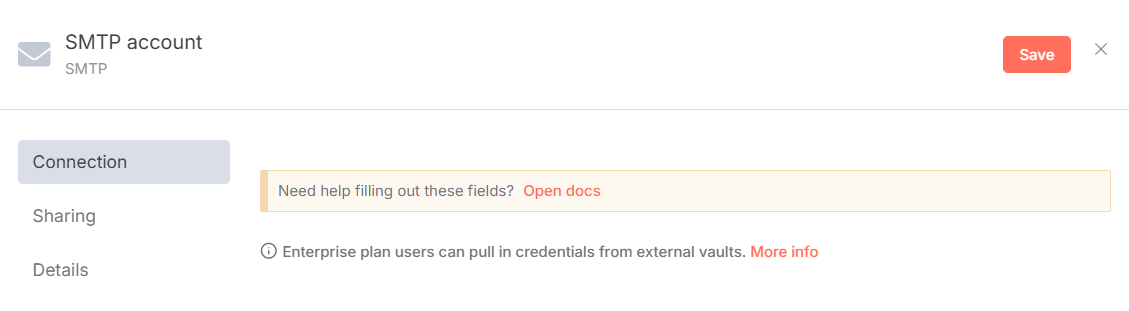

As it didn’t work after several tries, I wanted to check my credential and maybe try to add a new one to test, but even this part has a problem:
As you can see, I can’t add (or check) credential information.
So, I can’t send email nor create or modify credentials within the node.

Hey, does your instance run in Docker? Are all types of credentials affected? Like Google, etc.
See if your instance has an env variable N8N_DEFAULT_LOCALE set. If set, remove and restart the instance. There is an issue with this variable, which causes issues with some credentials.
It’s running on a render server, I think it’s like Docker.
It was the only credential I can’t access but it’s ok now thanks to jabbson advice.
