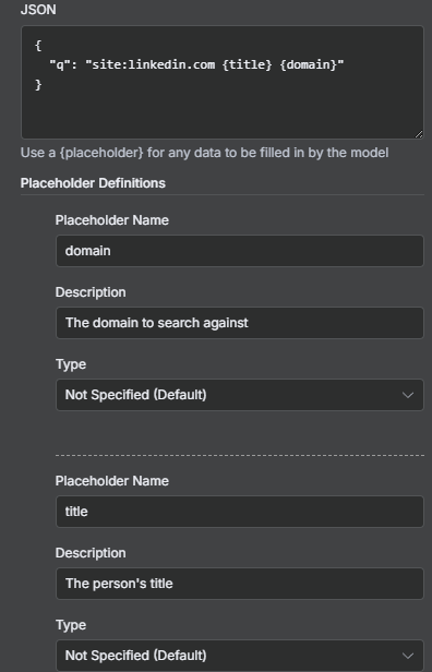

I am receiving an error when using the HTTP Request Tool when trying to include placeholders inside a JSON body.
I am using the HTTP Request Tool have have the following fields populated:
Method: POST
Send Header ON with content-type specified as application/json
Send Body ON
Specify Body: Using JSON Below
JSON (Fixed):
  "q": "site:linkedin.com {title} {domain}"
Placeholders including relevant descriptions: domain, title
I wouldn’t expect the placeholders included this way to interfere with JSON parsing since they are curly braces inside a string literal but it appears they are. I have tried using the expression mode instead and using {{ $json.title }} but it only iterates on the 1 row from the google sheet when done this way instead of iterating on each row. Should I be wrapping this in a Loop node?
Could not replace placeholders in body: Expected ‘,’ or ‘}’ after property value in JSON at position 29

Hi @brendan6 Welcome to n8n :n8n: community :tada:
You don’t need to specify the Type for the placeholder, It should work just like this:
If this solves your issue, feel free to mark the reply as the solution :white_check_mark::folded_hands:t2:
This worked!! Thank you.
I didn’t think that would be the issue. How is Type supposed to work?
I’m not exactly sure what happens under the hood, but my guess is that when you specify a type, it becomes mandatory, and the final JSON might end up looking something like this:
  "q": "site:linkedin.com "title" "domain""
Which, of course, isn’t valid JSON
So without a type, the placeholder likely just stays as {title} and {domain} without any extra quotes added…
