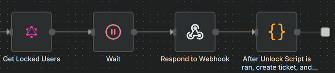

trying to run a PowerShell script via an RMM, which wont return my data, so im having the script POST to the webhook with the output i need, which will then resume the workflow and create a new dropdown in the next form page.
picture for example. cant send code. lol
