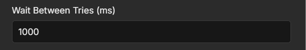

Every node: Retry on fail > max. 5000ms > why?
When I try to set the delay for retry after fail to something higher than 5000ms in any node, it set it back to 5000ms. I need this though, because some services fail at night for a few minutes or even hours and I need to be able to wait for the next retry longer than 5000ms.
n8n-retry_on_fail-5000ms_max
Why is the maximum 5000ms?

Hi @nm5182
that 5000ms snap-back isn’t a bug. it’s a hard limit n8n uses to stop long retries from completely freezing your worker threads.
for waits longer than 5 seconds, you have to build a custom retry loop using a Wait node instead. it safely pauses the execution in the database without hogging system resources.
the quick way to set it up:
  1. open your failing node’s Settings tab and change On Error to Continue (using error output).
  2. connect that new red error output to a Wait node (set it to however many minutes or hours you need).
  3. loop the Wait node’s output right back into the input of the failing node.
    Hope this will help you!
