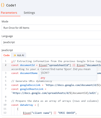

https://i.imgur.com/hZn407F.png I just switched it to run once per item, but its giving me this error now.
and to answer your question, none previous to what I just posted.
It says you need to return an object, while you’re returning an array that consists of a single object.
Remove square brackets in your return statement.
I’d recommend reading n8n docs on n8n data structure. It will clarify a lot to you.

I also updated the update node to try and just do one cell using a different input method, but still it doesn’t seem to update my value https://i.imgur.com/9B50ZCU.png
I’m receiving this in the chat https://i.imgur.com/5L4fjR3.png
Please post your updated code node. Unformatted code is hard to read.
Did you know you can paste screenshots with Ctrl/Cmd-V straight in the your message?
You do not need handlebars ({{ or }}) in Javascript code. The expression inside is a perfectly valid code (unless it contains errors of course).
Sorry about that. I’ve been primarily using ChatGPT to write the code and just problem solving as a go, as I haven’t actually learned proper coding. This is the updated workflow.
