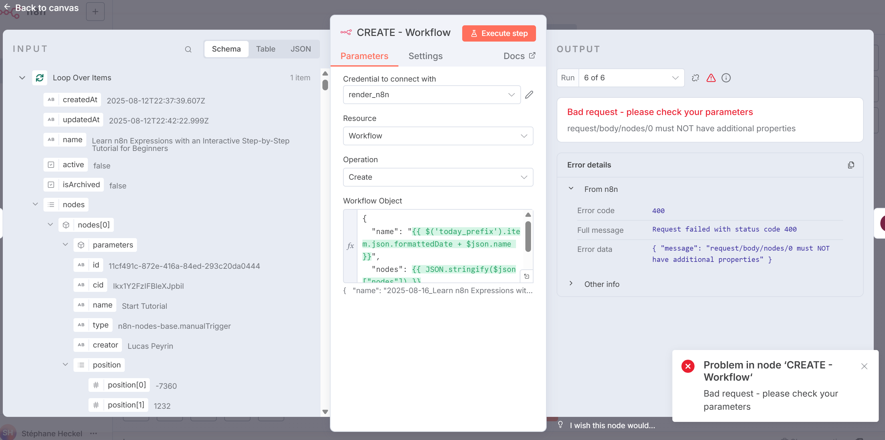

Hello,
I get the same error, if I try to backup this worklow [Learn n8n Expressions with an Interactive Step-by-Step Tutorial for Beginners](🎓 Learn n8n expressions with an interactive step-by-step tutorial for beginners | n8n workflow template) using my [n8n API backup process](Backup n8n workflows with versioning and Notion tracking | n8n workflow template)
request/body/nodes/0 must NOT have additional properties
Error code 400
Full message
Request failed with status code 400
Error data
{ “message”: “request/body/nodes/0 must NOT have additional properties” }
Not sure to understand what’s wrong, …
