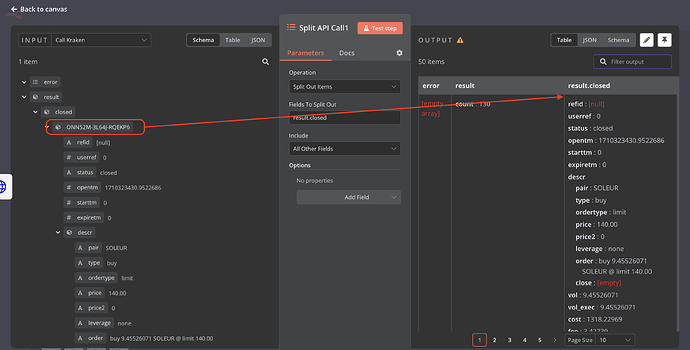

Hi all, I want to split a HTTP request and also return the object name. The splitting is going fine but I need to have the object name in the result as well as it’s the transaction ID. How could I achieve this? Thanks!

You need to inject the name of the key into that key.
The example below (will be created a new property with key “name”)
