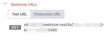

Https suddenly missing from webhook and callback URLs
Updated my self-hosted instance (Coolify on a Hetzner VPS) yesterday being behind almost 10 versions, and after that all my new webhook and callback URLs are showing and get copied without https://.
SSL is working fine for my instance, and webhooks work fine when I add the prefix https://, but callback URLs for various OAuths now fail when I try to make new connections (existing connections work well).

  • n8n version: 1.109.1

Your settings look ok although if your webhook and editor url is the same you only need to set WEBHOOK_URL
Do you have any other env options set as the issue looks like the options you have are not being picked up correctly?
These weird ones were actually for compose substitution, from some Coolify template from over a year ago I think :joy:
@krisn0x thanks for the tips, got it working now after clearing up my compose file and environmental variables, and removing some unnecessary compose substitutions that were overriding the domain instead of URL for the editor base url
