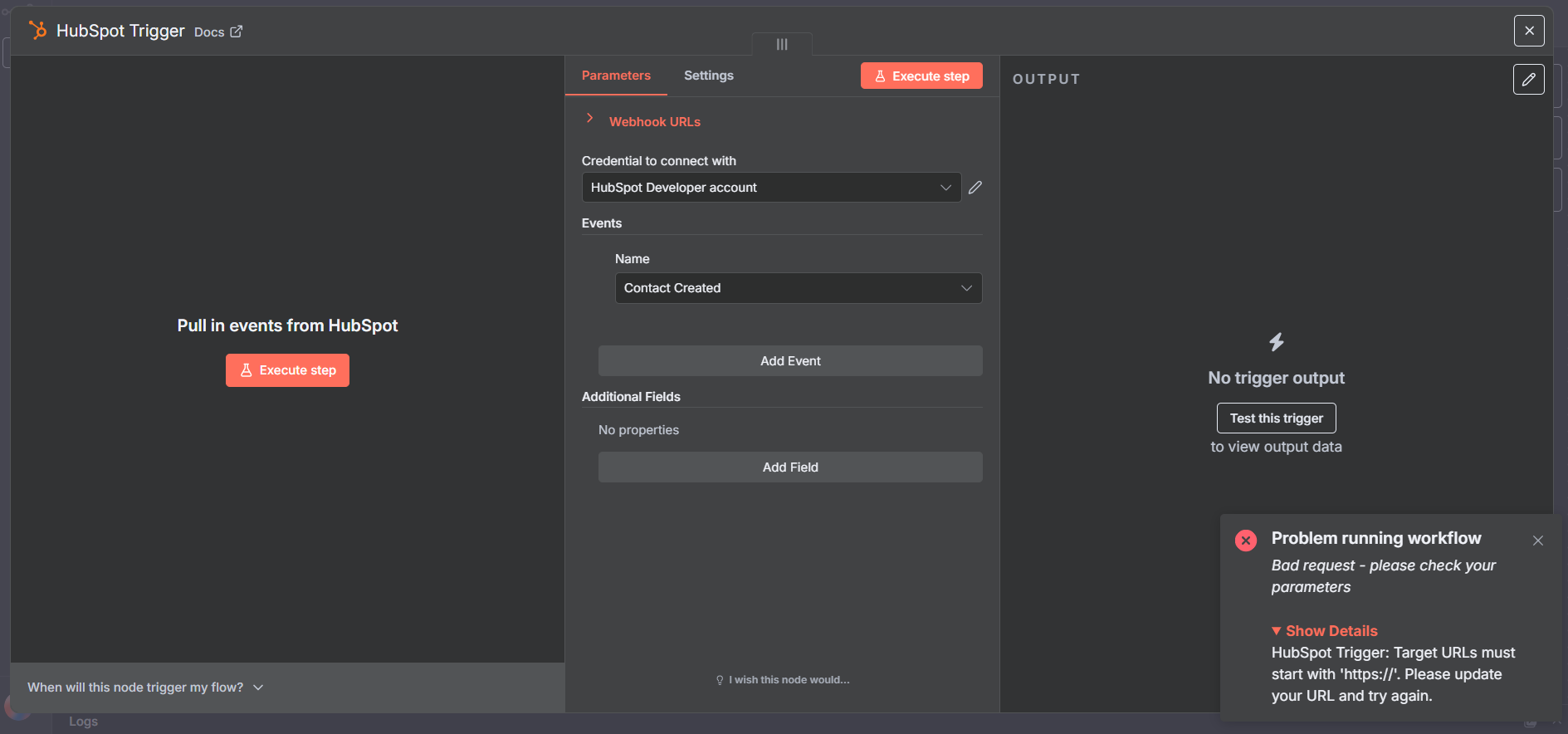

HubSpot Contact Create Trigger not showing any events when listening
I’ve authenticated HubSpot trigger by creating a public app, and everything is saying connected. However, when I listen to an event, nothing appears even if I create the contact in HubSpot manually, or send a contact automatically through a separate integration.
What could the issue be? (Also when I try to press the “Stop listening” button nothin happens and n8n freezes.
What’s the issue and why isn’t it picking up that contacts have been created and so it should trigger the workflow?
I Am Facing The Same Trouble
As You Can See In Above Image
The Redirect URL Which We Are Getting in n8n Credentials that Must URL Must Be A Production URL So Try To Active Your Workflow First After That Provide The Redirect URL To your developers.hubspot Website To The App Connected To n8n
I Am Sure It Will Work
Thanks, it is now working!

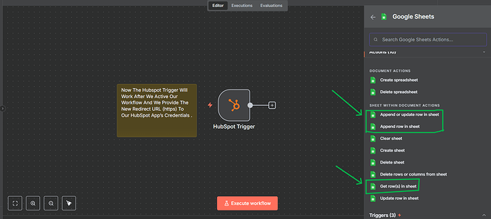

Although one thing that is a complete pain, whenever I trigger the webhook, and I get the output. I can then use this output for the next step. However, if I exit the flow and come back to it, that output isn’t saved, and so I have to create another trigger to get another output. Is there a way around that? It is so frustrating and makes testing so much more time consuming
Alright ,
I Think You Should Try To save the output somewhere whether in a google sheet or a database
I am sharing you a screenshot of google sheet in which you can (append a row) to push output in google sheet & then you want to get the output you can get the output with (get rows) .
Let Me Know If It Is Working Or Not .
