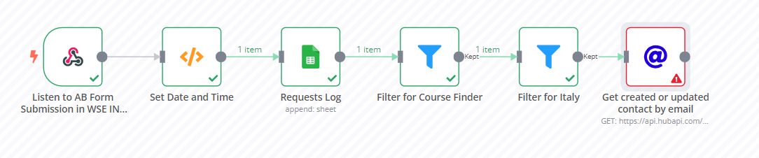

An HTTP Request to GET a contact by email in an Hubspot org fails even though the email is available in the Node Input data and the expression returns the correct value when building the workflow. The node executes tests correctly without outputing data (already a red flag) and then it turns that dreadful red and “undefined” at all real life executions though.

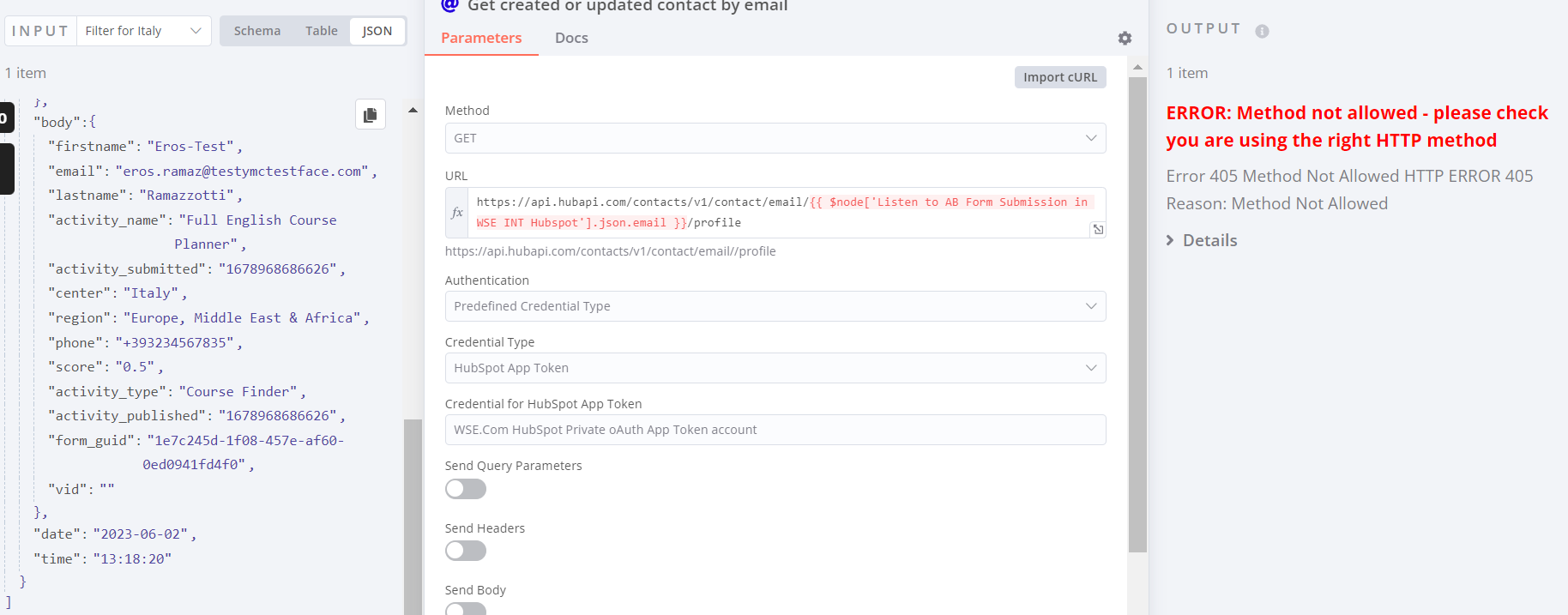

I believe the issue is in the expression included in the url to dynamically populate the email part inside this endpoint url (as per: Hubspot: Get Contact by email API endpoint).
For example for my use case I tried https://api.hubapi.com/contacts/v1/contact/email/{{ $node[‘Filter for Italy’].json.email }}/profile (based on the ouput of the node straight prior to this one) and https://api.hubapi.com/contacts/v1/contact/email/{{ $node[‘Listen to AB Form Submission in WSE INT Hubspot’].json.email }}/profile (based on the initial webhook trigger node which starts the workflow when a form is submitted). They both have the email in the data.
Important to say that when I test this endpoint url in Postman by putting an email address that exists in the org, I do get a result. This is also a testing method I tried on the node to no avail (it “executed successfully” without outputting data).
Another info is that the credentials to authenticate the request I use is the bearer token of a Private Auth App in the org. I checked it was still valid and it works in other similar requests via Zapier and Postman.
ERROR: Method not allowed - please check you are using the right HTTP method

When testing the node on its own: output = nothing, even though the endpoint url seems correc. I tested both by inputting an email address that exists in the Hubspot org and via the method I want to use i.e have a enpoint url with the “contact email” section populating dynamically thanks to an expression returning the email that is part of the output of the very first node or that of the one just prior to my request. Both “succeed” as tests without ouputting anything (I want the contact’s vid/hs_object_id returned at the very least).
When testing via an execution of the workflow through mock submitting a form: the expression suddenly returns “undefined” meaning the endpoint url becomes
https://api.hubapi.com/contacts/v1/contact/email//profile and the output is then the error mentioned above

Oddly enough that error would suggest the issue is with the request method but it looks like the node is set to use a Get which should work. It could be that the data is empty like you noticed in your test as well are you able to share the actual workflow and the data you are sending to the webhook so I can take a look?
Hi @Jon Sure. Apologies for the belated reply. I actually duplicated the workflow and moved that node straight after my webhook trigger one which activates it and now it works. Still don’t know what was the issue prior though as I did not change the expression (i.e the second option tested before https://api.hubapi.com/contacts/v1/contact/email/{{ $node[‘Listen to AB Form Submission in WSE INT Hubspot’].json.email }}/profile )
