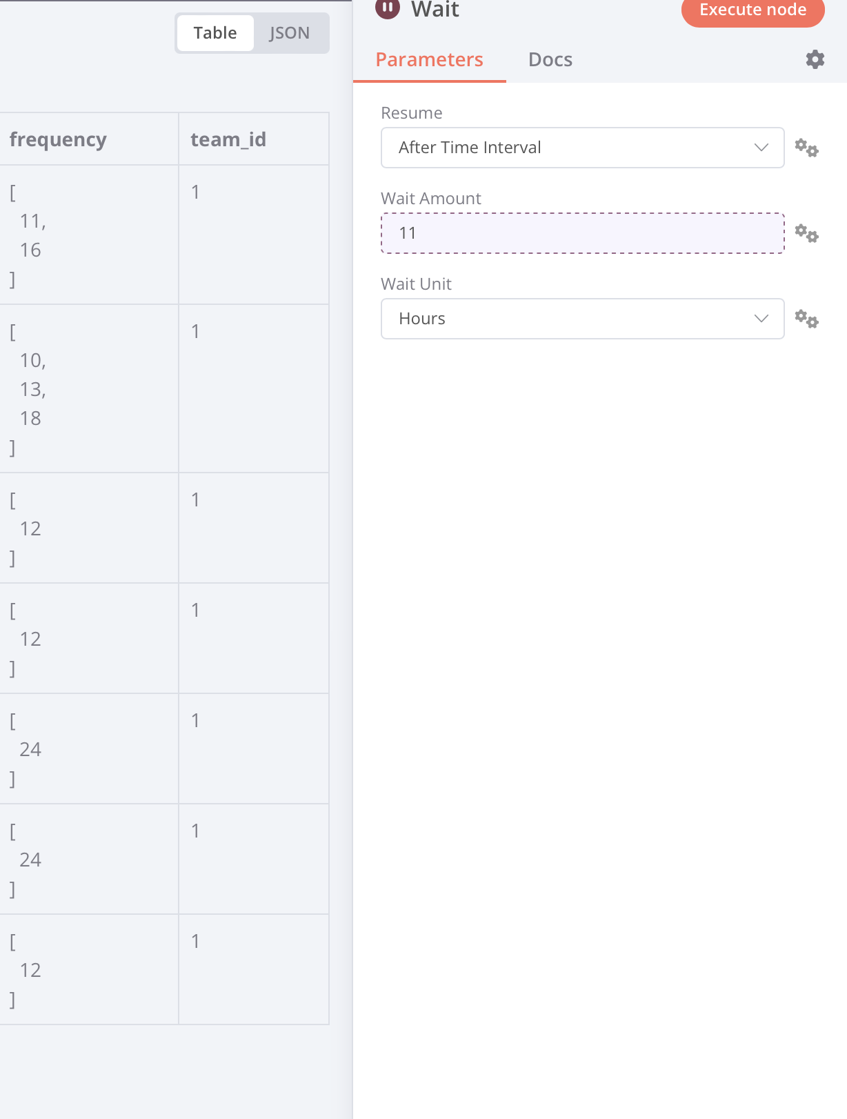

So if I just add a wait and kick it of each 24 hours, would this work?
Meaning that I don’t do the hours of the day, but just “each 11 hours” for example.

I want to run a http request based on a frequency set from an item list. Each item can have different values.

I am totally fine with having “each x hours” per items. It doesn’t have to be e.g. hour 10 & 18 of the day.
