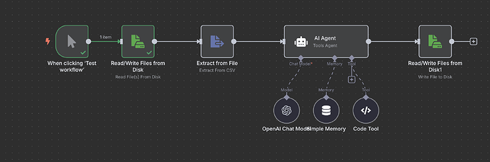

Hi, testing n8n rn and I can’t seem to load a simple csv file, which is pretty annoying.
The flow looks like this and is supposed to take in the csv, clean the data & output a cleaned dataset (again i csv)
I’m currently stuck at csv extraction which looks like this;

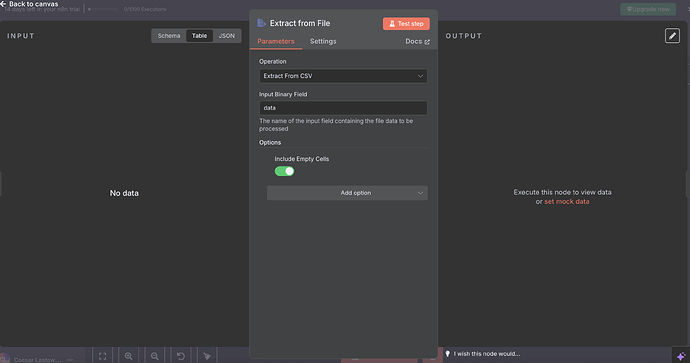

This is my extractor settings:
However, the issue is that Read from Disc doesn’t work as it should (no output). I resaved the file as @Gon mentioned but it didn’t help. Ofc I tried loading from different locations, with different names and triple checked the path to file.
Any ideas on what might help?
@Caesar_Lastowski
Did you manage to fix it? btw this could be because of how ure instance is hosted, are you using dockers? because this path will be /home/node/.n8n/ by default, if you want to access local files and using dockers you need to specify differently.
