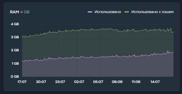

I think your decision helped me, now there are no sudden RAM spikes. Now the consumption reaches 2GB. Do I need to leave the setting - NODE_OPTIONS=–max-old-space-size=2048, which I added earlier?
@Danilov_Vovka depends on the instance size, you can probably remove tbh, btw if working much better now, I would highly appreciate marking this as the solution if okay, be much appreciated.

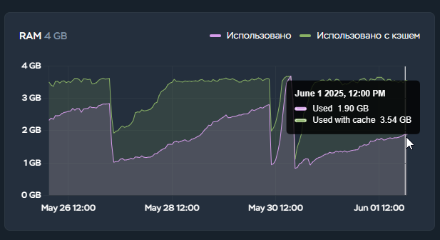

unfortunately, the RAM gets clogged anyway.

PID 590773 (node): 1.9 GB is the largest consumer.
PID 831 (dockerd): 54.7 MB.
PID 2314 (traefik): 52.2 MB.
PID 2305 (portainer): 48.5 MB.
PID 590887 (node): 110.2 MB.
CONTAINER ID NAME CPU % MEM USAGE / LIMIT MEM % NET I/O BLOCK I/O PIDS
55321cbc6f73 n8n 0.12% 2.017GiB / 3.824GiB 52.74% 1.18GB / 2.96GB 1.48MB / 90MB 20
785b27587867 postgres 0.00% 179.9MiB / 3.824GiB 4.59% 2.89GB / 293MB 1.45GB / 3.43GB 7
873d181fa495 portainer 0.00% 28.08MiB / 3.824GiB 0.72% 12.8MB / 90.7MB 111MB / 401MB 6
4f58718a9cdb traefik 0.00% 38.54MiB / 3.824GiB 0.98% 1.04GB / 1.03GB 160MB / 6.37MB 9

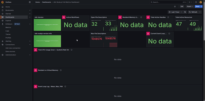

I tried to deploy grafana, but I have something wrong. metrics are not counted, although N8N gives them away locally.

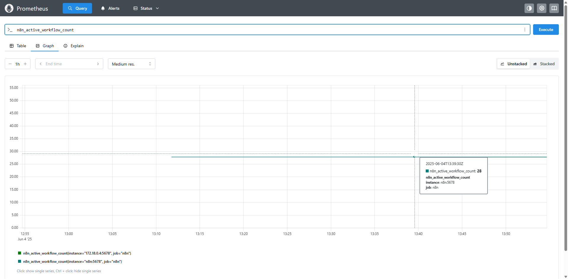

The target is active and data collection seems to be working.
then why don’t the charts in the dashboard work?
@King_Samuel_David

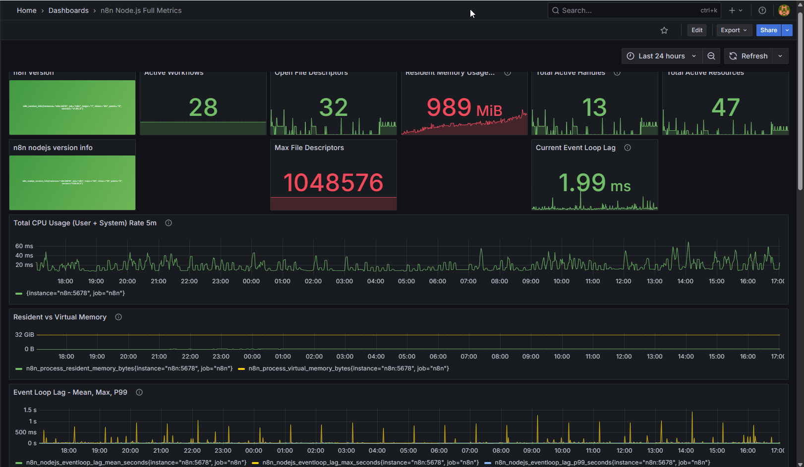

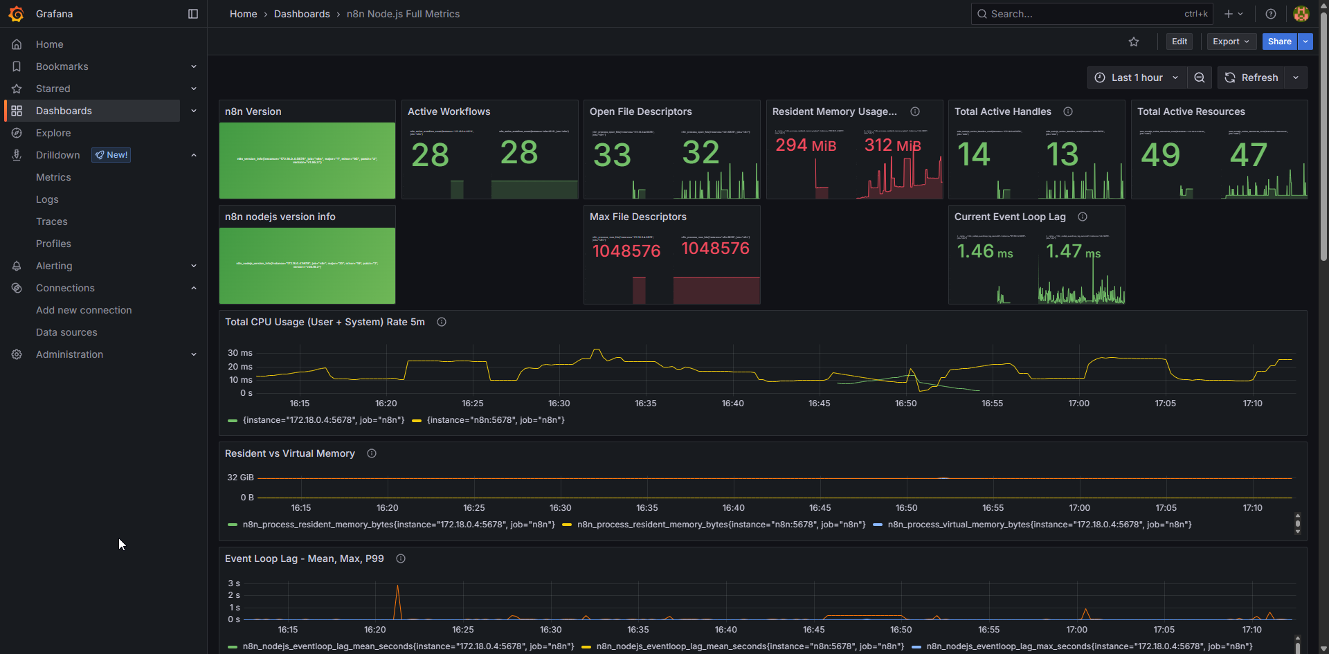

I think I’ve managed to set up grafana. how many metrics do I need to collect and which ones?
@Danilov_Vovka
Hello
I would be watching the GC as it may be the issue, if you notice anything, that matches the spikes and drops, then this should help identify the issue further.
Best regards,
Samuel

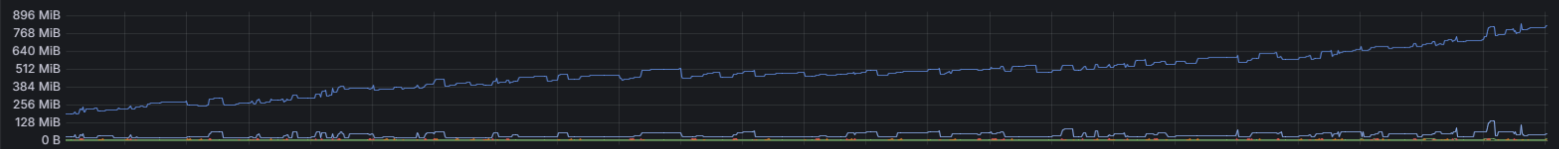

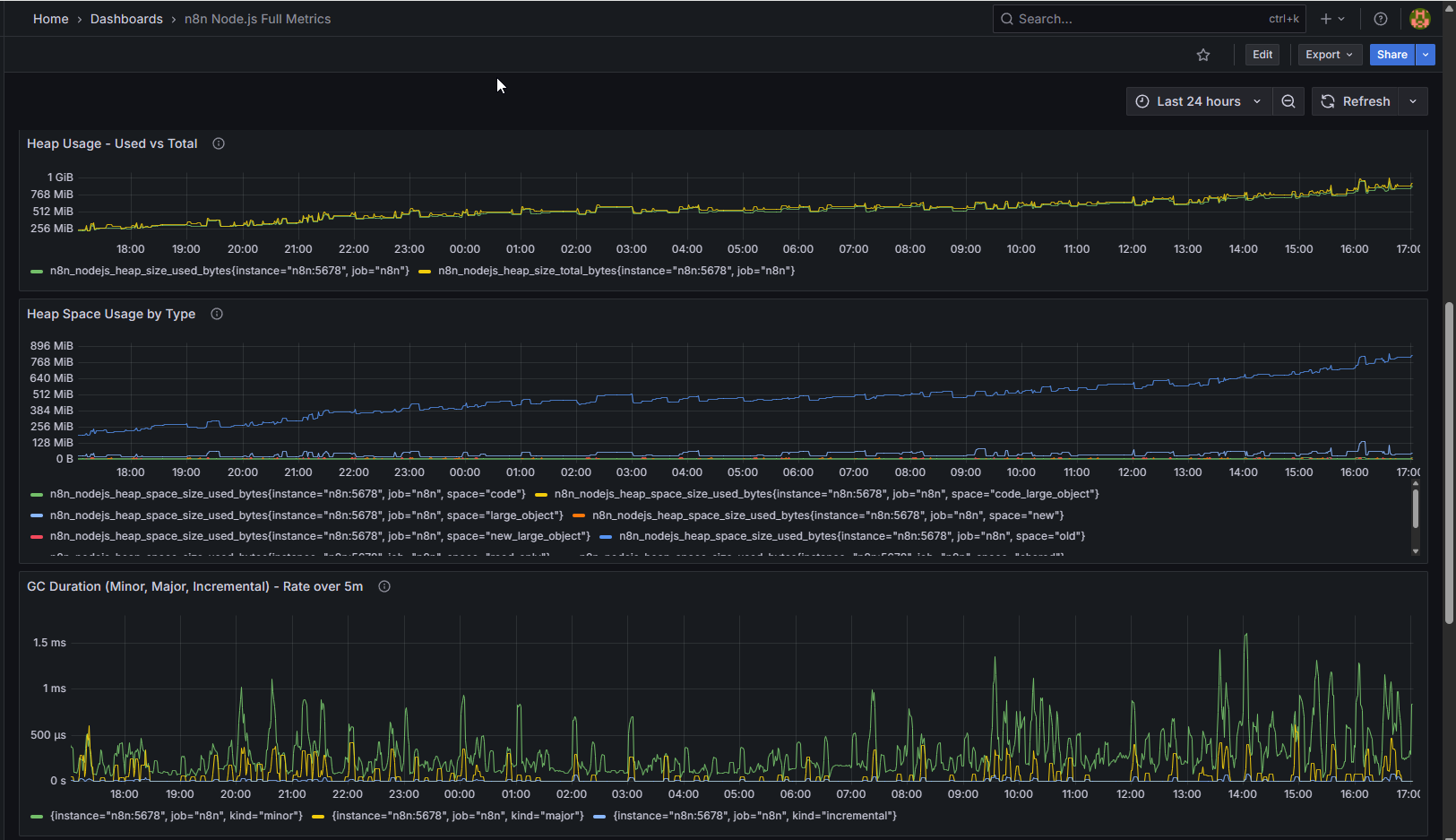

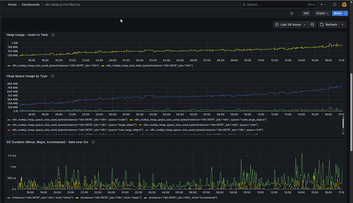

@King_Samuel_David
Hi.
Statistics have been collected for the last 24 hours since the n8n crashed due to lack of memory:
Will it be possible to identify a RAM leak?

Hey @Danilov_Vovka
It looks like heapspace old, grows and grows, over this period, other things look consistant like event loop lag,
I think you can try change the value, it may help. I noticed you set at 2gb already.
NODE_OPTIONS=--max-old-space-size=<limit>
You can try disable Taskrunner, this will use more mem I believe or maybe adjust concurrency
N8N_CONCURRENCY_PRODUCTION_LIMIT=3
N8N_DEFAULT_BINARY_DATA_MODE I would try this first, enabling filesystem storage not memory,
Hopefully changing these will help, please do monitor further, am wondering if there are any other options, I dont think this is consider a RAM leak, as this is normal behaviour of heap spaces, In Node.js, the “old space” refers to the part of the V8 heap where long-lived objects are stored after surviving several garbage collection cycles.
Samuel

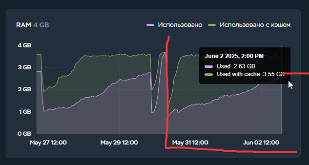

I have previously used the settings NODE_OPTIONS=–max-old-space-size=2000 and N8N_DEFAULT_BINARY_DATA_MODE=filesystem
I have now set the size to 1024 and added mem_limit: 1024m.

I’ll keep watching
Made some edits above, thanks, you have filesystem enabled. and it 100 percent node process, hmm did you try disable runners?
Samuel
Mod - N8N_RUNNERS_ENABLED=true I haven’t tried disabling it yet. But I also think it’s because of him, because I didn’t use this mode last time.
I’ll check the stats in 24 hours.
