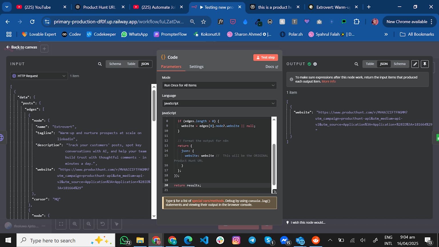

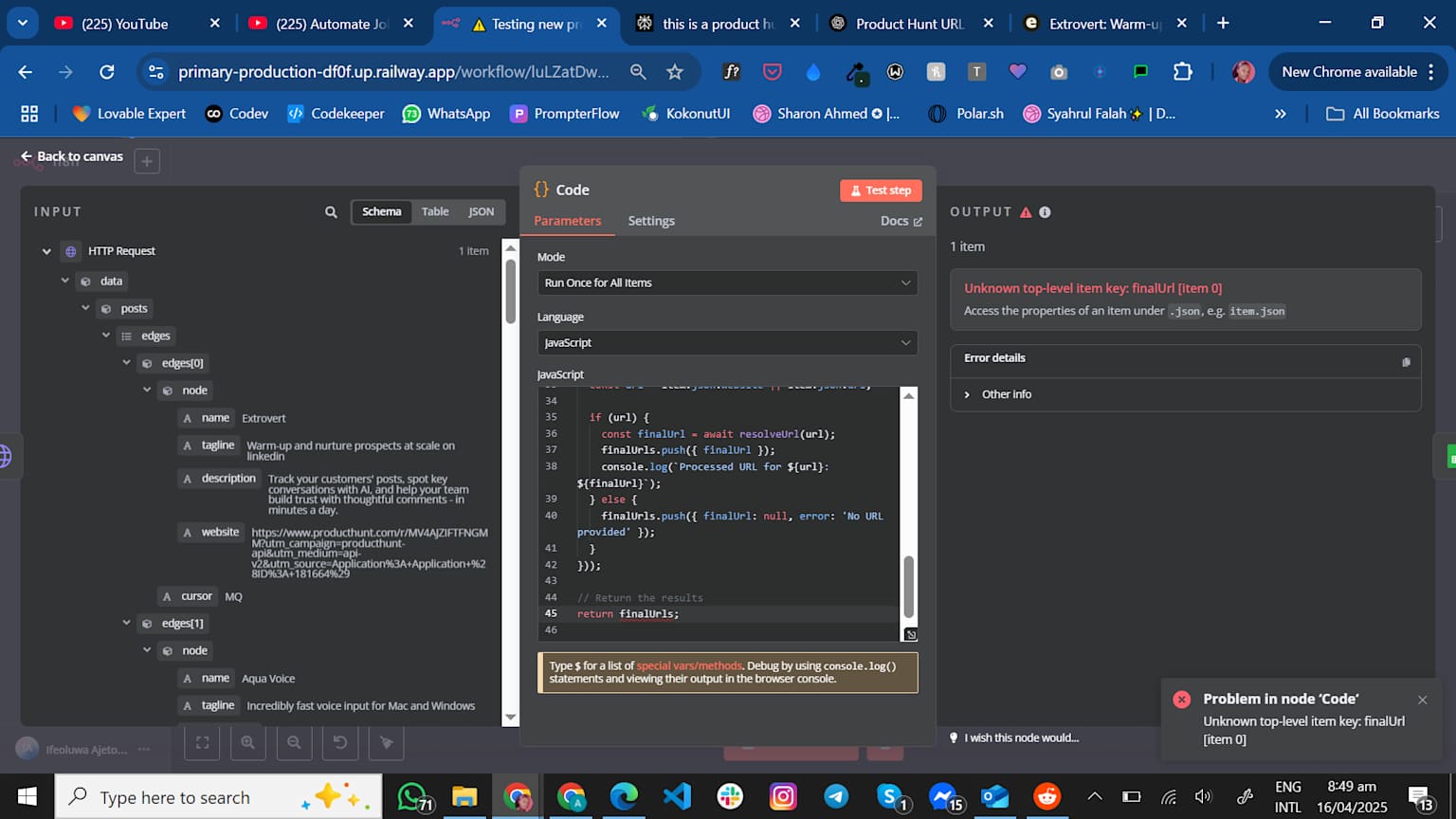

I’m using a Code node with JavaScript to extract the data and attempt to resolve the redirects. I’m using n8n’s $http.request to follow the redirects, but for some reason the finalUrl still show up as null.
Here’s the code in my Code node:
javascript
// Code node to extract product data and resolve redirects
async function resolveRedirect(url) {
    try {
        const response = await $http.request({
            url: url,
            method: 'GET',
            followRedirect: true,
        return response.request.options.uri; // The final URL after redirects
    } catch (error) {
        console.error("Error resolving redirect:", error);
        return null;
const products = items[0]?.json?.data?.posts?.edges || [];
const results = [];
for (const edge of products) {
  const node = edge.node;
  let finalUrl = null;
  if (node?.website) {
    finalUrl = await resolveRedirect(node.website);
  results.push({
    json: {
      name: node?.name || null,
      tagline: node?.tagline || null,
      description: node?.description || null,
      website: node?.website || null, // Original Product Hunt URL
      finalUrl: finalUrl, // Final URL after redirect
return results;
I’ve tried various approaches, but I’m still stuck. Any help or suggestions would be greatly appreciated!
