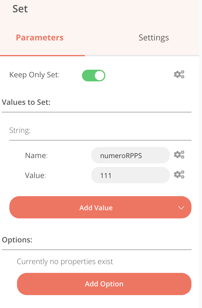

Can you share a picture of the output of the set node? Also what type is the field numeroRPPS in airtable?
Set node result :
Set node result with the “keep only set” :
The field type in Airtable is “single line text”. This is the default type when adding data via CSV.
ahh then that is the issue. You can use string in the set node or change the field type in Airtable to number.
Indeed. No more error. But still, the numeroRPPS has not changed.
pb update3 airtable
I’m wondering if the process send the right information because here is the result of the update node :
There’s no trace of the “numeroRPPS” = “11111111111” defined in the set node.
