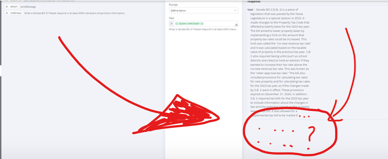

@Derek_Cheung Your suggestions won’t help I don’t believe. It’s simply that the response is getting cut off at the end. Here is an example of what I see in Slack and also what happens in n8n. I think it’s a bug in n8n to be honest. I believe the model to be responding correctly. But, somehow the back-end code of n8n is shortening the character limit displayed.
@Derek_Cheung Actually, I tried what you said and it did help not get the response to be cut off anymore. So, thank you so much for that.
I changed the model and tested the Max Number of Tokens between 4000, 8000, 12000, 16000. Still my Slackbot response is limiting out around 3200 characters tops. Asking for more sections and rules actually really helped extend (increase the number of characters in…) the response. I am trying to get it to respond with more. But, it won’t listen to my minimum character limit request. Thoughts?
I thought telling it to respond in a certain amount of characters would do the trick. But, it hasn’t.
This response had 3,158 characters in this snapshot above.
