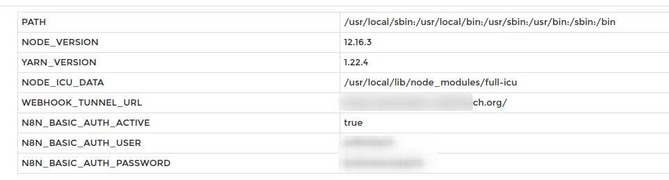

I have enabled WebHook Tunnel URL in env too.
n8n is running on VPS behind the Nginx Reverse Proxy. And I’m using Test Webhook URL
