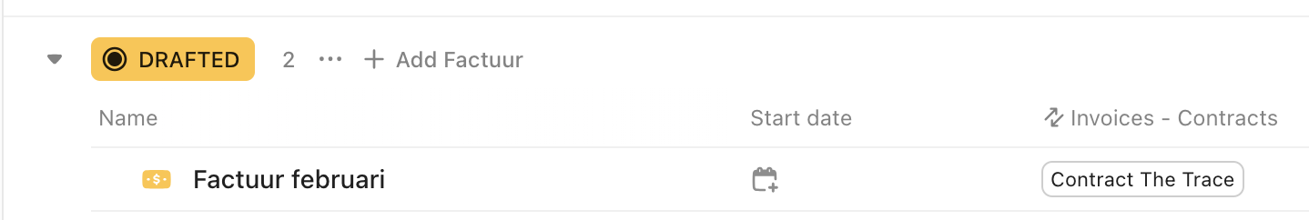

I want to use n8n to set a related field in the tasks i create. however no matter what i try it doesn’t seem to work.
i can link tasks, i can create dependencies. however i’m trying to create a specific relationship (invoices - contracts] and would like the link to the other task to show like in the example below.
does anyone know how to achieve this? i have tried using create node, update node and http request node. i can manage to write json that runs but the created task always ends up having a empty field for this “relationship” field.

its weird to me that this is not possible. in the native automation module within clickup i am able to set it exactly like this. the only problem is i am not able to dynamically pick up the ID of the contract task.
