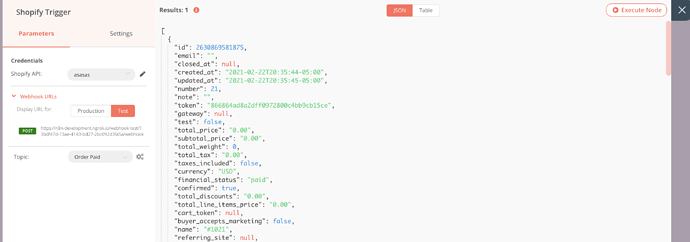

n8n checks if the data it receives is really from Shopify. It that is not the case, it ignores it. I wonder if something changed there. We will have a look.
About your second issue. Are you talking about testing? Because in production it should work just fine. Only when testing does n8n check if there is a node which expects a webhook call an waits till it receives it. If you do not want that, you have to temporary disable the node when you test/develop.
@Veit_Nachtmannv just tested it and it’s working fine. I would double check if shared secret is correct.
