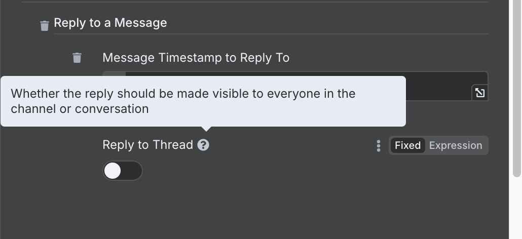

Stumbled upon this one recently. I dug around the source code and found out that you can achieve this by disabling the Reply to Thread toggle. The option name seems misleading.
sorry, that is wrong, that makes it reply just in the channel and not in the thread, what we want is that it replies in the thread but not in the channel
What version of n8n are you on? On version 1.90.1 this works exactly as you want.
You should still set the timestamp to reply to.
It’s just that you should disable the Reply to Thread toggle.
The help text also suggests so, although I missed it and ended up digging around the source code.
you are completely right, I just tried! life saver! thanks!
