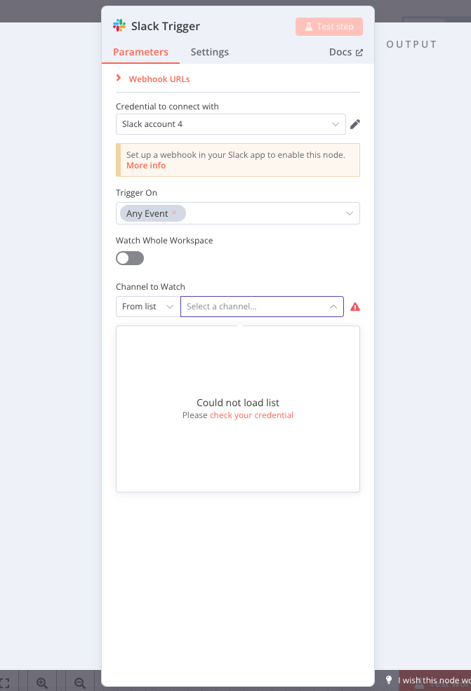

I am creating a new workflow with a Slack Trigger node, to trigger on any event (for example, doesn’t matter which trigger I select), then I open the “channel to watch” dropdown, and it won’t load the list of channels (error is “Could not load list / Check credentials”).
I have follow all the relevant instructions, given the respective Slack app I created the correct bot scopes (basically I tried giving all possible read scopes, still not working).

actually I am unable to type in the textfield, as while it’s still loading, once I click into the text field, the box closes. and once it’s done loading and errors out, I also cannot use the textfield any longer.

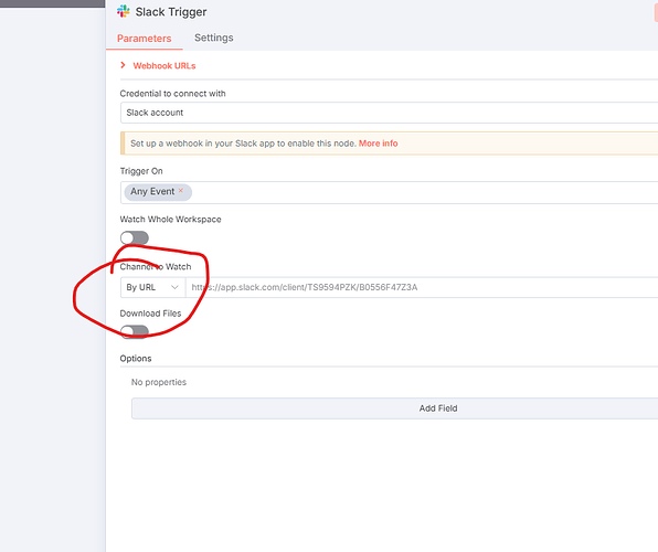

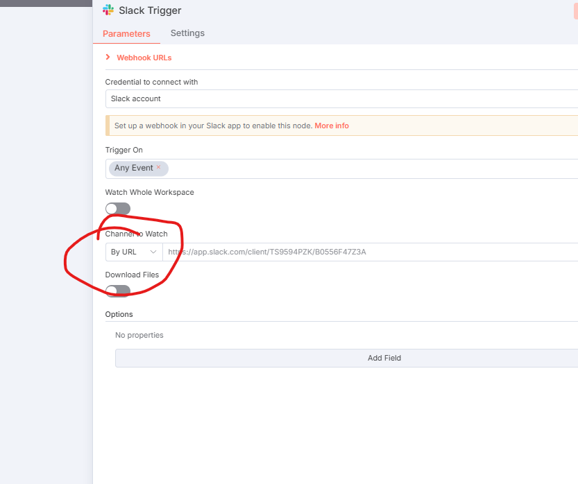

change it to by url so its not checking for channels. Heres an image for how to do that.
Hi @rbeer I tried both by channel and by ID - they are both not working. There is no more error, but when I test the workflow step and trigger events (messages, reactions, etc) inside that channel, they do not get picked up by n8n.
