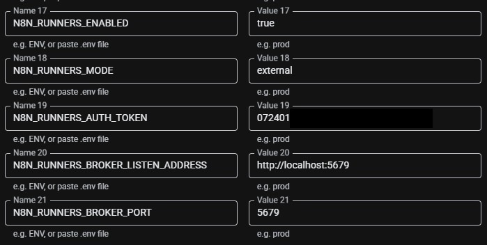

Unfortunately, as soon as I introduce the new environment variables, the main instance starts responding only with 404s. Can you tell me what I’m doing wrong?
These are the environment variables on the main service

As you can see, despite the error I receive, the environment variable is set. What am I doing wrong?

You’re not doing anything wrong with the infrastructure. The problem is exclusively a mandatory configuration issue for Task Runners in external mode.
When you set:
N8N_RUNNERS_ENABLED=true
N8N_RUNNERS_MODE=external
n8n requires that:
N8N_RUNNERS_AUTH_TOKEN
  • Be defined in the main instance
  • Be defined in all runners
  • Have exactly the same value (byte by byte)
If this doesn’t happen, n8n fails during bootstrap, starts the HTTP server without registering routes, and the external result is 404 on everything.

I’m pretty sure I’ve done all the necessary tests, but setting N8N_RUNNERS_ENABLED=true
N8N_RUNNERS_MODE=external seems to have solved something. N8N_RUNNERS_AUTH_TOKEN is retrieved from a secret for both cloud run services, both the main and the task runner, so I’m sure they have the same value.
