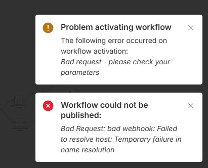

[UPDATE] Telegram Webhook Issue Evolved - Now Getting DNS Resolution Error
Update to Previous Issue:
This is a continuation of an ongoing Telegram integration problem. Initially had different errors, but after troubleshooting (including regenerating bot token), the issue has evolved into a more specific DNS-related problem.
Current Situation:

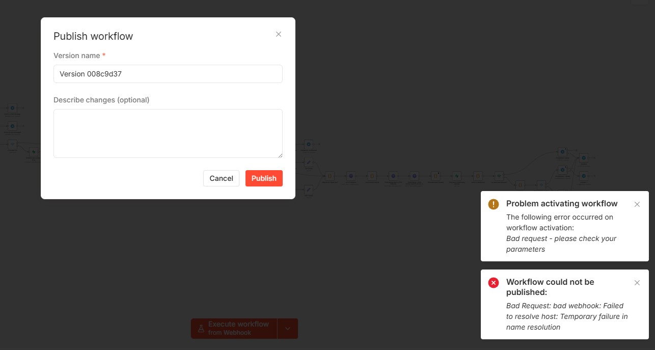

Unable to activate ANY Telegram workflows. All bots affected simultaneously. Getting consistent error when trying to publish/activate workflows:
Bad Request: bad webhook: Failed to resolve host: Temporary failure in name resolution
CRITICAL OBSERVATION:
  • Workflows with Telegram Trigger that are ALREADY published/active → WORK FINE :white_check_mark:
  • If I deactivate them → CANNOT re-activate/publish :cross_mark:
  • Workflows WITHOUT Telegram Trigger → publish/unpublish without any issues :white_check_mark:
  • Problem is ONLY with Telegram Trigger activation/registration process

What We’ve Verified: :white_check_mark: DNS resolution works INSIDE n8n container (docker exec + nslookup resolves domain correctly to IP) :white_check_mark: Domain is publicly accessible from external networks :white_check_mark: SSL certificate is valid (curl -I shows 200 OK) :white_check_mark: All environment variables correctly set in both docker-compose.yml and .env file :white_check_mark: n8n generates correct webhook URLs :white_check_mark: Webhook endpoint accessible (returns expected 404 when workflow inactive) :white_check_mark: Non-Telegram workflows publish/unpublish normally :white_check_mark: Already-active Telegram workflows continue to work
The Paradox:
  • n8n container CAN resolve the domain :white_check_mark:
  • External browsers CAN access the domain :white_check_mark:
  • Already-registered Telegram webhooks WORK :white_check_mark:
  • NEW Telegram webhook registration FAILS (Telegram servers claim DNS error) :cross_mark:
Additional Testing:
  • Manually calling Telegram API’s setWebhook → same DNS error
  • Calling getWebhookInfo → webhook URL field is empty
  • Suspicion: Telegram’s infrastructure suddenly cannot resolve .ru domains during webhook registration (possibly regional DNS/network restrictions)

The issues persist: I even deployed a clean n8n instance on a different IP and domain and updated to the latest version, but the problem remains. When trying to register a Telegram Trigger webhook, Telegram returns errors like “Failed to resolve host” or “Connection timed out,” even though the domain resolves correctly, SSL is valid, and the endpoint is accessible via browser and curl; at the same time, my previously published workflows with Telegram Triggers continue to work fine, while any new or reconfigured trigger fails to set the webhook. Could this be related to how n8n registers webhooks or external connectivity issues, and is the Telegram Trigger currently working normally on your side?
