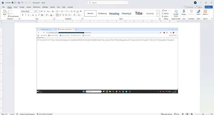

Hey @Parintele_Damaskin i tried it and it’s still not working, i also checked the webhook with postman like how this person recommends (Solved: Telegram Trigger configuration ) and at first it says it’s deleted and then when i cop the url into body it says the webhook is working.

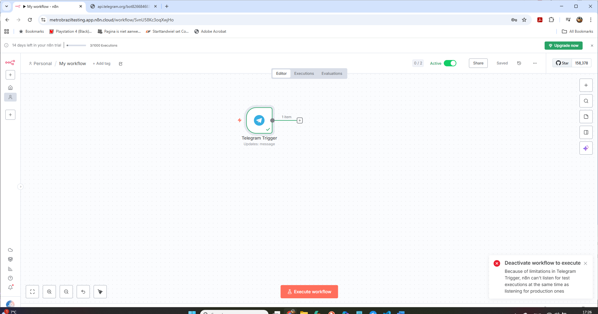

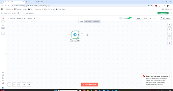

@Parintele_Damaskin i created a fresh n8n cloud account, fresh telegram bot just to test the triggers’ functionality, however, even in there i get the same;
Deactivate workflow to execute
Because of limitations in Telegram Trigger, n8n can’t listen for test executions at the same time as listening for production ones
so i don’t think it has anything to do with my proxy after all, this is really strange, am i missing something in the telegram setup itself perhaps?
For testing, deactivate the workflow(toggle in right corner top the button) and use “Execute workflow” / test mode.
For production, activate(toggle back same button) the workflow and test by sending real messages (no test mode).

this is not an error. it is the way telegram works. you can only set a single webhook per bot. that totally make sense

hey, @ramIn1 thanks for helping , i just registered it and the webhook was set properly, i used the production url but it didn’t work, should i restart my n8n to confrim that it really doesn’t work?

@Parintele_Damaskin see the picture above, everything is fresh, here is the workflow, fresh aswell;
i created a workflow and set the production url for one of my bots and it did work.
i add the Telegram Trigger and activate my workflow and set the production url for my bot webhook url using https://api.telegram.org/bot/setwebhook
ok. what happens if you send a message using telegram bot
because you activated your workflow, you are not able to call your workflow manually anymore. that is totally fine. but you can send a message in your bot and telegram will deliver it to n8n and execute your workflow
