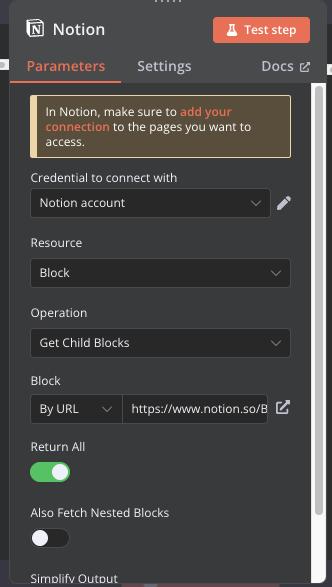

I’m trying to connect a Notion Node. I’ve setup connection in Notion. I’ve added the credential in N8N. Both were successful. I’ve copied the url and followed numerous youtube videos but no data is coming back. It keeps print the same error as if it’s having problems connecting though the API tess are coming back as successful.
I get error message in N8N, “In Notion, make sure to add your connection to the pages you want to access.”. I disconnected the connection and re-added it and removed and re-setup API connection in Notion as well. Not sure what is wrong. This is a fairly straight forward thing.

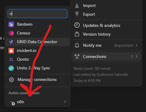

Hey, I think I know how to help you.
First check if you have this in your Notion page/database that you want to access.
Make sure your are logged in as the owner of the workspace. Guests can’t manage integrations.
Thanks for response. I’m trying to connnect to a specific page instead of a database. I’ve confirmed connection is there in Notion but it’s as if it’s not seeing it on the page from N8N.
