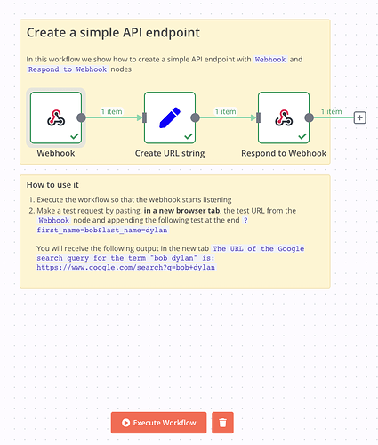

I tried this scenario with google and Bob Dylan and it works.
But when I take the webhook-url and insert it to my book-like-a-boss-bookings I don’t get any data.

Does only that example not work or do you not get any webhook node to work?
What does it display you when you call that URL? Is there some kind of error message?
I just want to add… What request type are you making? The Webhook node is set to use a Get request not a post request so it should work from your browser, It is also worth confirming that your Webhook URL doesn’t start with http://localhost:5678.

@jan The example works. The connection to booking-like-a-boss (BLAB) doesn’t work …
