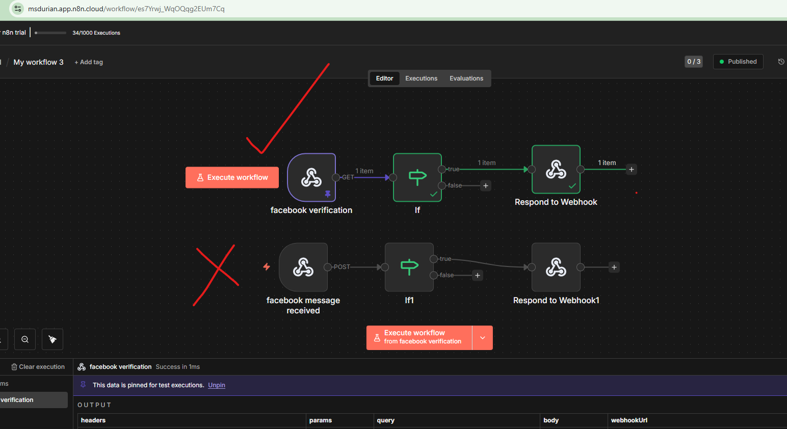

Please help. I am new to n8n and want to do ai chatbot for messeger. The problem right now is the webhook(post) keep loading until timeout when i execute the workflow. I have tried the webhook(get) to verify at meta and everything was fine, but i send message to the page account the webhook post is not respond at all. Kindly point me out if i missing any part, thank you
the webhook(post) keep loading until timeout when execute the workflow

thanks for the reply, but the problem is still persists on my side. i have try it again, in cloud with publish and production url (without test). i tested also the webhook post with and without respond to webhook. For right now only webhook post having issue, webhook get no issue, done the verification with meta. I cannot go to the next step without the webhook post.

Thanks for the explanation, but from my situation, i have done 2 webhooks(get and post with same path) and 2 Respond to Webhook node, the first one which Webhook get can reach to Meta and done the verification. Then next i tried to reach the Webhook post by sending the message to the page account, it keep loading until timeout. i have check with other tutorial but dont see the problem yet. You can check from my json above. Thanks again for helping newbie(me):man_bowing: .

@Anshul_Namdev i have set a seperate POST webhook with respond Immediately and Respond Code 200. And then setup a http request node to send message back to meta immediately after this webhook node. But the result is not working, the POST webhook cannot trigger at all, same situation. i re-do everything again by follow youtube video and also the template from n8n, but result the same, no one can help me to reach the POST webhook node
