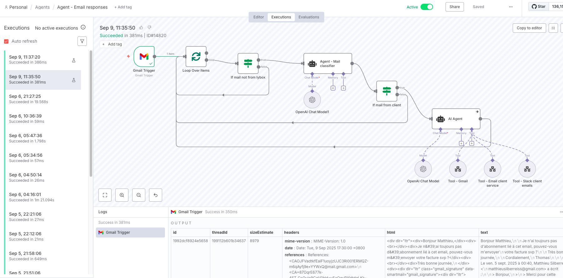

I’m experiencing an issue with one of my workflows. For the past three days, it hasn’t been triggering automatically, even though it was working perfectly before.
I haven’t made any changes to the workflow during this time, and it is still marked as active. When I run the test manually, as you can see in the attached screenshots, everything works fine. However, the automation doesn’t trigger on its own anymore.
I am still receiving emails in Gmail without any issues, so the problem doesn’t seem to come from my Gmail account. I can’t figure out where the issue lies, and I would really appreciate your help to resolve this.

Thank you for your answer. here is the trigger which is set on every minutes. I don’t feel like it has something to do with this because this workflow was working fine for more than 2 weeks, and then stopped.
