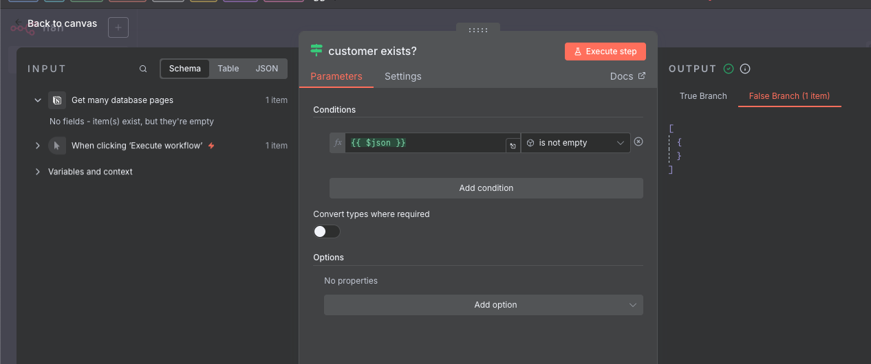

you set Notion to always output, not if. In the if node then you check
{{ $json }} object is empty.
To elaborate, here is how it would work:
You output empty object if no customer is not present in the database:
then in the if node:
All together:
Thank you, that works perfect :+1:t2:
