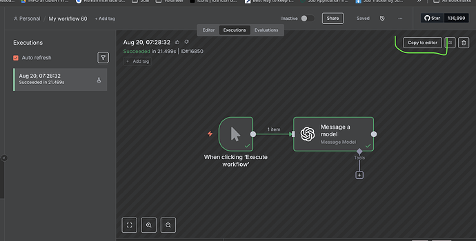

Hi there @Max_Kessler , have you tried using copy to editor?
it will bring your execution data and pin it in your editor tab, that way you can try to execute it manually and the failed data should be pinned (do note that i think the one that is pinned is only like the earlier nodes, like only the start), and then that way you can try to execute your workflow manually to simulate the failing execution with the failing data

Yes I tried that, but when you click on a node it just starts the execution again from the trigger (start) of the workflow.

This happens to me as well, I copy to editor and can clearly see the green workflow with data and errored node, I just want to fix the node with error and run it but it always starts again from webhook and runs everything again.
