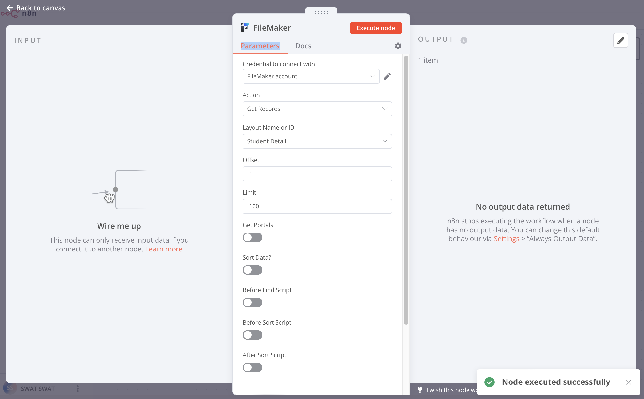

Hey, @Jon,
Thank you for getting this image up, and the Filemaker authentication works as long as I keep the setting “Ignore SSL Issues” turned off. My tabes are loading and everything is working except I am not receiving any output data. I have “Always Output Data” turned on, and I am still not getting anything. I do not know if I am doing something wrong, I probably am, but n8n also says that the node is being executed successfully.

Hey @Swat_1,
It should be ok with Ignore SSL Issues set to enabled, Out of interest is there any extra log output?
Hey @Jon,
When Ignore SSL Issues is enabled I get the same error as before (ERROR: self-signed certificate in certificate chain).
This is the output with always output data on and ignore ssl issues off.
I do not know of any other way to view a log than it showing up after I execute the node, their probably is another way, so let me know how to find it, and I will send it to you.
