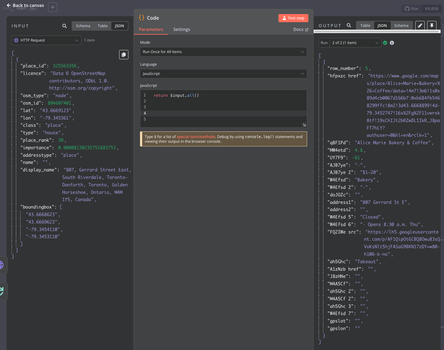

I’ve migrated that Merge to a Code node. I want to grab from the inputs (Loop node and HTTP API Request node) and put them together into a nice little json item that I can use downstream.
Problem is that the Code node won’t see the API request data, which is seen as valid. Both inputs are valid.
I’m not sure why I can’t see both inputs. I’ve tested for both inputs and secondary (api request) is empty.
Any ideas?

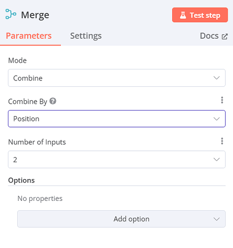

If you weren’t to have fields with empty values the Merge node Combine by Position should have worked just fine.

You need to Merge threads before Code. Check the template I shared above.
I do not see overlap across filed names from both inputs.
Shouldn’t Merge Combine by Position meet expectations?

OK I tried the merge. Here is the result, which only shows the Loop output:

OK, tried various ways of extracting those values, different javascript, and the http request, although it seems it’s working fine and outputting proper json, isn’t undefined in the workflow.
Am I missing something? I simply cannot this parsed out.

I think Google Sheet node receives a list of objects and works them one by one. First object in the list doesn’t have rownum property hence undefined.
In the Merge node you need to change merge type to Combine from (I assume) Append.
