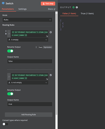

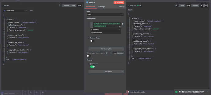

How can this switch run both on true and false, if im setting it to be is empty on one and is not empty on another?
**n8n version:1.7.43
Database (default: SQLite):
Operating system:
affibox
January 30, 2025, 12:48pm
2

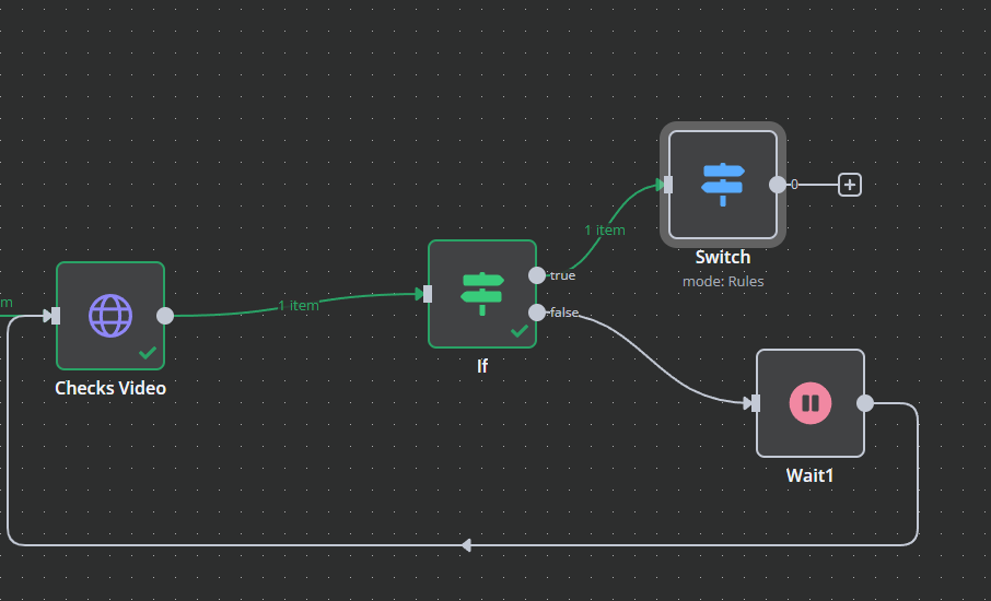

I wanted to confirm this issue. switch is not passing any data at all on all my tests.
On existing workflows is not even working when I activate the “allways output data”
UPDATE:
I recreated an existing workflow one node at a time and now the switch is working.

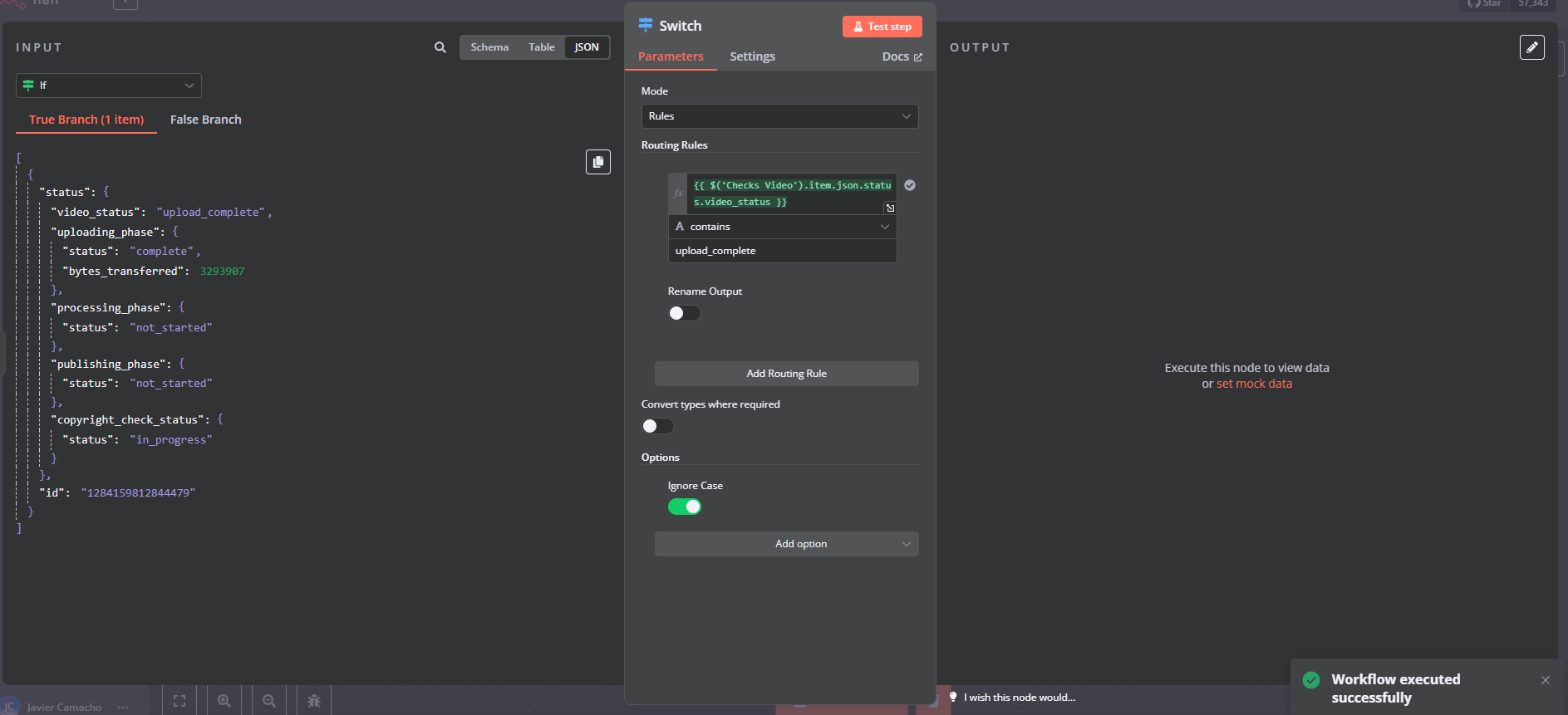

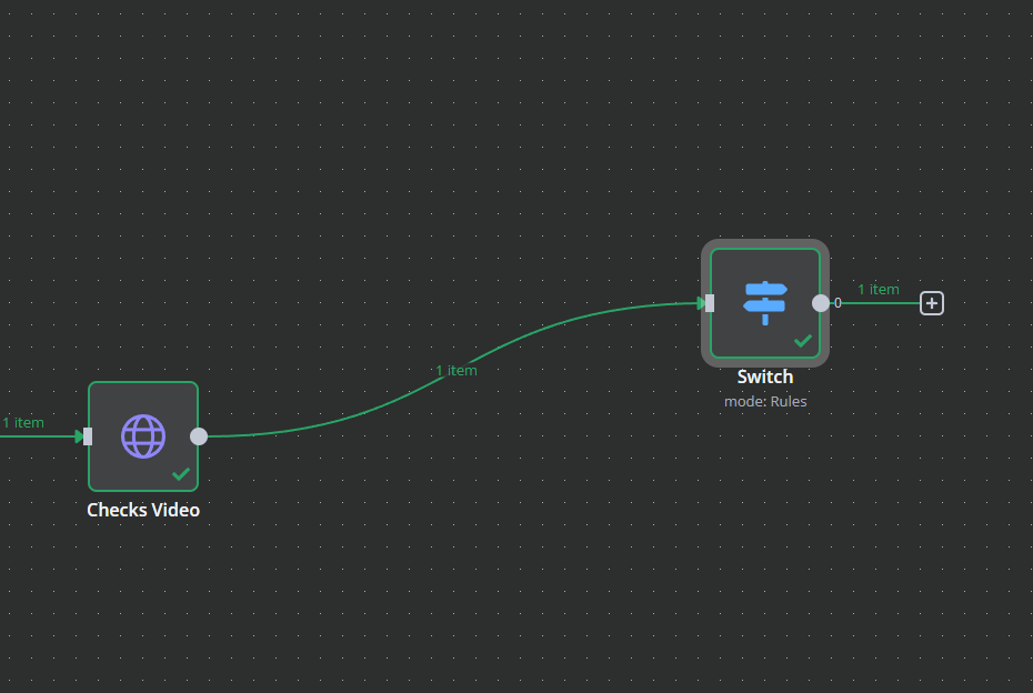

BUT… if you apply a a switch after and if the workflow just stops and no data is been output from switch
This is with the switch directly connected and with the if removed:
