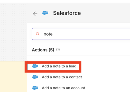

Salesforce Note not getting added to "Lead" object using " using "Add a note to a lead"
I am not sure If I am doing something wrong, but when I use the “salesforce” node to “Add a note to a lead”, it only creates the note in salesforce, but not associate the note to the lead.

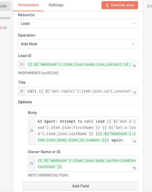

Here is my settings for my note named “Add a note to a lead”

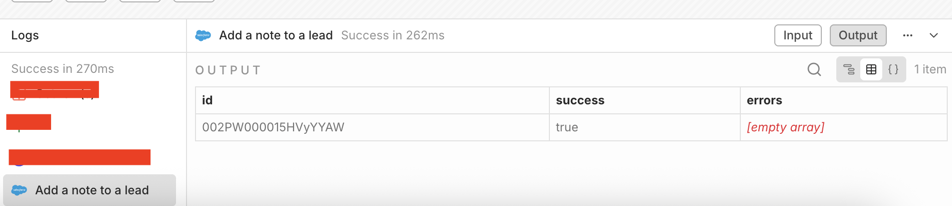

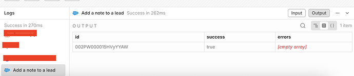

This will produce salesforce note id, but not associated with the lead.

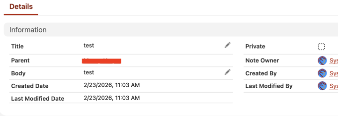

I can see the note created in salesforce.
However when I open up the lead contact, I do not see that note that was create in the note section as it was not associating the note with the lead object.
Hi @mhaque, welcome to the n8n community!
the “Add a note to a lead” node uses the classic Note object from Salesforce. If your org has Enhanced Notes enabled, those notes won’t show up linked to the Lead because Lightning uses a different structure under the hood. To get it working correctly you need to create a ContentNote and then a ContentDocumentLink pointing to the Lead, setting the LinkedEntityId as the LeadId. That’s the current Salesforce standard for notes in Lightning environments.
