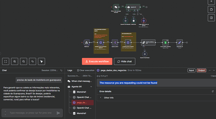

The resource you are requesting could not be found | HTTP - WEBHOOK connection error
I cannot start my project… But i dont have any idea with can i fix this error
the http can’t connect with webhook and send me a error mensage always…
i think this is so dumb question but i really need help
Hey @Jvdcarli hope all is good. Welcome to the community.
Could you share the URL the node is attempting to get the content for?
Can you share your workflow here?

the n8n forum blocked my mensage haha exceed the char limits
OK, it appears that you get the 404 (page not found), because the webhook
https://n8n.zunoassessoria.com.br/webhook-test/112bb213-d3a9-442e-8c8a-1f55c890429e
is not running. Since you are using -test url, the webhook workflow needs to be manually activated before another workflow can access it.
If the workflow you are trying to reach is in the same n8n, you may also want to use Call n8n workflow tool instead. But if you want to make an http request, then you have to activate that other workflow first.
When I try to post to it, I get the same 404.
Ah, and make sure the webhook trigger is in the different workflow.
